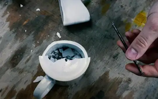

Image taken from this video. A ton of similar videos (1,2,3,4,5) claiming to show the "Rehbinder effect" went viral several months before.
For soft wettable materials like paper, immersing in water decreases its stiffness, by untangling the fibers holding it together. But ceramics? Aren't the bonds too strong to get weakened by the action of water? I feel like this effect has more to do with the propagation of vibrations on the cup rather than its material properties, which might explain why the medium plays a role.

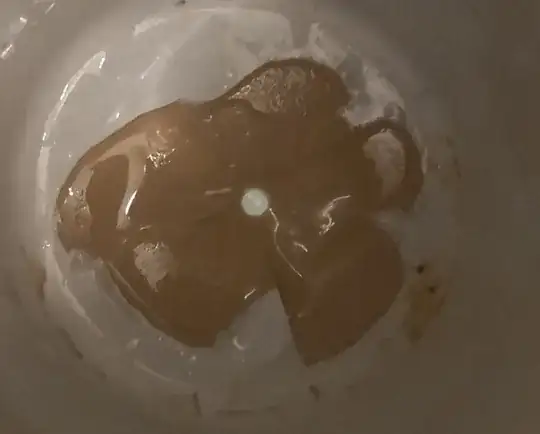

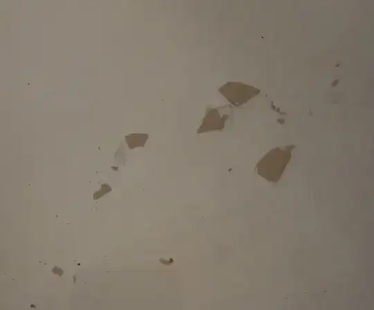

Not an answer, but I did the experiment and it works (mostly) and you can't put photos in comments.
The nail drove a neat looking hole in the cup. enter image description here
Turning the cup over revealed that the interior had spalled. enter image description here
Fragments of broken ceramic from the cup. enter image description here
