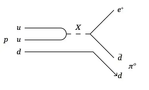

Our observations tell us that baryon and lepton number are conserved, within the accuracies of our experiments and observations. This means we have chosen as a standard model SU(3)xSU(2)xU(1) because in the group structure of the possible representations of all the quantum numbers assigned to the particles and resonances we know, there is no exchange particle that could change a proton to something else and no calculable Feynman diagram like:
protondecay
This means that within the standard model the probability for a proton to decay is zero with any precision in the perturbative expansions which we calculate crossections with.
Extending the standard model, i.e.stating that it could be embedded in a higher group's representations, as an SU(5) model, with the standard model embedded, introduces new particles that can be exchanged, which carry lepton and quark numbers such that their exchange allows a proton decay. In this specific model these diagrams have been calculated and give a lifetime of order of 10^36 years.
