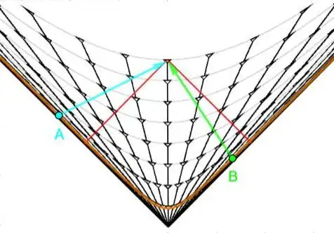

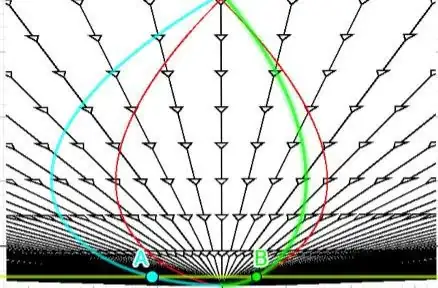

RETRACTION: My first answer agreed that an anisotropic one way speed of light should be noticeable when making cosmic scale observations. After giving it some more thought I am retracting that position: I initially assumed that if light was travelling at 2c its travel time from emission to reception would be approximately half the age of the universe. That seems reasonable, but unfortunately, it was a wrong assumption because light travels differently in an expanding universe.
Take a look at the diagram below (I borrowed the background from the excellent website on Cosmology by Ned Wright)
This diagram represents the spacetime of galaxies being carried outward by the Hubble flow. Due to the galaxies co-moving with the expanding space in this model, the outer galaxies do not experience time dilation relative to the observer at the centre so proper time advances equally everywhere and a line of simultaneity according to the central observer is simply a horizontal line. The proper time of the receding galaxies is the same as the coordinate time of the central observer. The red curves are the light paths of isotropic light where the speed of light is equal in all directions. The light blue curve is the path of light that is travelling at 1.5c from left to right in an anisotropic universe. The green curve is the path of light that is travelling at 0.75c on its return journey from right to left in the same anisotropic universe. The horizontal yellowish line at the bottom represents the time of 'first light' after the recombination event when the plasma of ions produced by the big bang condensed into normal matter that allowed light to travel normally. This is essentially what we observe as the CMB. It can be seen from the diagram that light emitted simultaneously at first light arrives simultaneously no matter which direction it comes from, in an anisotropic universe. The observed redshift is proportional to the amount of expansion of the universe during the light travel time and since the coordinate travel time of the light is the same in either direction, the observed redshift of the CMB will the same from either direction. Whichever direction you look in, you see just as far back in time and there is no way to deduce the one way speed of light here.
This second diagram is a coordinate transformation of the first model, to the Minkowski space of Special Relativity. The galaxies are treated as if they are projectiles in flat space, moving outward from the central observer. In this model the outer galaxies do experience time dilation relative to the central observer. The lines of simultaneity are now hyperbolas because proper time is no longer equal everywhere. The orange hyperbola is the time of first light in this diagram. Calculations of velocity from redshift now have to take into account, time dilation due to relative motion in this model, but nevertheless distance/velocity/redshift measurements are the same as in the first model. Observations in either direction both see right back to the time of emission of the CMB and both directions see the same redshift for the CMB in either direction. The time of emission in terms of proper time (age of the emitting object) is the same in either direction. The 'surface' of the CMB is effectively moving away from us at close to the speed of light. As a result of this, there is extreme time dilation and while light emitted at event A was emitted at a later coordinate time than light emitted at event B, the proper time of emission is the same. The two models are almost indistinguishable, but we cannot safely conclude that the galaxies may be simply moving as projectiles in flat space. For one, the flat space model cannot account for the accelerating expansion (which is not modelled in the above simplified diagrams). Projectiles necessarily move with constant velocity in flat space.
