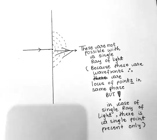

Huygens' principle is a great way to explain diffraction when light rays are incident on a slit, but how would one explain the diffraction of a single light ray crossing a slit?
6 Answers6
I planned a comment, but after reading the existing ones, I think a direct answer addressing the main conceptual issue could be more appropriate.
There is nothing like a straight-line, one-dimensional ray. The only attempt at producing it would destroy such a ray.
It is a well-known misconception to think of the rays of geometric optics as trajectories of light particles. They aren't. Rays in geometric optics are just a set of infinite lines perpendicular to the surfaces of a constant phase of the wave.
Amazingly, a question on a single ray is embedded in the context of Huygens' principle, which should be enough to exclude it. Indeed, if a wavefront was reduced to a point, Huygens' principle says that this point would be the source of a system of spherical waves. Said in another way, if we try to make such a single ray by a screen with a hole, the smaller the hole, the more spherical the fraction of the wavefront outcoming the hole.
A final comment about photons. Photons cannot restore the concept of a "single ray." There is nothing like the trajectory of a photon, according to the basic principles of Quantum Mechanics.
Huygens principle works when light is treated as a wave. Here, the diffraction patterns arise due to the interference of different points of the wavefront. However, when you talk about a single ray, this is in the geometrical optics limit of light, and the Huygens principle does not hold anymore.
So you might ask, what do we expect if light is really taken as a single ray? But how do we even create a single ray (when even lasers have a Gaussian profile)? A good starting point would be to reduce the intensity of light, so we shoot only a few photons at a time. But then, a quantum mechanical description of light would need to take over Huygens's principle.
However, for good reasons, one avoids talking about trajectories of particles in QM. Instead, we talk about what can be observed. So again, we cannot talk about a ray. But that won't bother us if only a single photon arrives at the slit in a given interval of time. For such a case (partly quoting from Wikipedia) - In QM, during the light propagation through a slit, each photon is described by its wave function. The latter determines the distribution for the photon on the screen, which is a probabilistic choice of one of many possible paths in the electromagnetic field. These probable paths form the pattern: in dark areas, no photons are landing, and in bright areas, many photons are landing.
So if your light is of low intensity such that only a few photons arrive at the slit in a given interval of time, QM predicts that an interference pattern should be detected on the screen. The conclusion is akin to Huygens principle but now in the low-intensity limit.

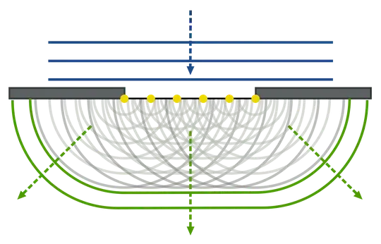

This idea works in $3$ dimensions too. Light from a point source is an expanding spherical wave. An extended source is a series of point sources.
You can take this idea a step further. Suppose an extended source generates a plane wave that propagates to plane A and continues to plane B. If you put an extended source at A, you get the same wave at B. It is as if a plane wave is a series of point sources that continually generate expanding spherical waves as it propagates. This gives correct description of the propagation of a wave.
This idea makes sense in a mechanical wave, where a medium is disturbed, and each disturbed point is a source of further disturbance. If you think light travels through aether, this evidence supports your thinking.
If a plane wave travels through a slit, some of the point sources are cut off. If you add up the waves of those that remain, you get the correct pattern for single slit diffraction. So diffraction is a consequence of the wave nature of light. It can be described as the difference between ray optics and wave optics. You can understand it without knowing anything about light other than light is a wave that interferes as dictated by its phase.

If you have a plane wave arriving at the slit and are asking what happens to a single ray, the Huygens principle says it acts like a point source and adds to all the other point sources. It doesn't have a diffraction pattern in isolation.
You might have a very faint plane wave arriving. It can be so faint that only a single photon passes through the slit at a time. The photon passes through all of the slit, not just a point. Diffraction occurs because the photon has a wavelike nature and interferes with itself.
You might have light focused to a point inside the slit. This might be spherical waves headed toward the focus. An important real world example is a laser being focused to the smallest, most intense spot possible. Using ray tracing, it is possible to design perfect lens that focuses all rays to a perfect point. But light is a wave. Diffraction limits the minimum spot size.
A good quality laser typically has a Gaussian beam. The beam is approximately cylindrical. But the intensity falls off exponentially as you get away from the beam axis. And rays do not quite follow straight lines. The wave front is a slightly converging spherical wave that flatten into a plane wave as it passes a beam waist. Then it curves into a slightly diverging spherical wave front. The rays perpendicular to these wave fronts follow hyperbolic paths. Far from the laser the beam is approximately a cone with a very small divergence angle, typically a few milliradians.
A Beam Expander is two lenses just the right distance apart. Using ray tracing, one lens focuses the beam to a point. The other takes light expanding from the point and turns it back to a collimated beam. But what you really get from the first lens is a Gaussian beam that is a sharply converging cone. It passes through a very small waist and expands into a sharply diverging cone.
To produce a useful small spot, you might just use the first lens.
If you focus the laser to a spot that is smaller than the slit, the electromagnetic field does not fill the slit. Or equivalently, the wave describing the state of the photons does not fill the slit. The diffraction of the beam is the same with or without the slit.
Using Huygens' principle, you add up waves from point sources only where you have a wave. The diffraction pattern of the beam is similar to that of a pinhole the size of the beam. Smaller slits/pinholes produce wider diffraction patterns.
