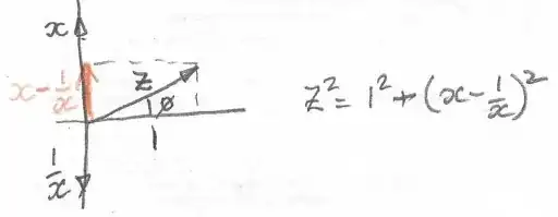

With the current $i$ as the reference for phase the phasor diagram looks like this:
The current in the circuit $i=\dfrac vZ= \dfrac{1}{\sqrt{1+\left(x-\frac 1x\right)^2}}$ if the applied voltage $v=1\,\rm V$.

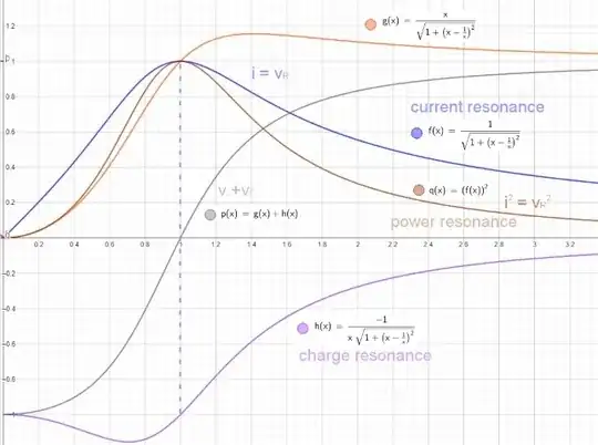

This is what the graphs as the frequency $x$ is varied look like.
You see that current (velocity in the mechanical case) resonance and power resonance occur at $x_0=\frac{1}{\sqrt{LC}}=1$ but charge (displacement in the mechanical case) resonance occurs at a lower frequency.
I think that a lot of the confusion arises because it is relatively easy to measure currents in electrical circuits but much more difficult to measure velocities in mechanical cases and so in mechanical examples the amplitude (maximum displacement) is measured.

But if we analyse it from impedance aspect $I_0$ is expected to be occur at $\omega_0$ where inductive effect and capacitive effect kill off each other.
This is not true. Maximum amplitude occurs for $\omega$ slightly different from $\omega_0$ whenever there is non-zero friction $\gamma$. This can be found from the formula for amplitude $I_0(\omega)$ in the usual way, i.e. we seek $\omega$ for which $dI_0/d\omega = 0$. When $\gamma$ is not zero, this frequency differs from $\omega_0$, and is associated with phase shift between current and voltage that is not exactly 90 degrees.
Resonance frequency is defined as that frequency which is associated with phase shift of 90 degrees between current and voltage (or velocity and force in mechanics), and this is almost always denoted as $\omega_0$, and in case of simple RLC element, it is equal to $\frac{1}{\sqrt{LC}}$.
