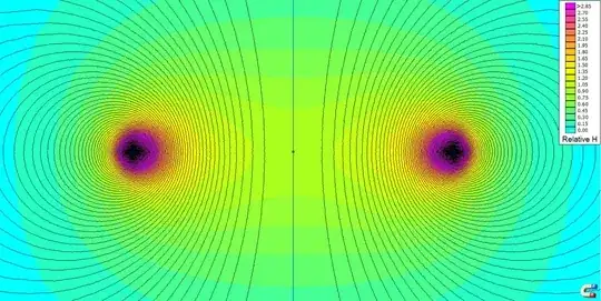

Here is the magnetic field pattern for a single loop.

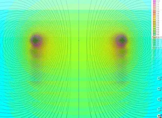

See what happens as more loops are added but please not I do not have the facility to change the colours to reflect a larger field strength and to combine the field lines.
The diagram below is just copies of the first diagram displaced and superimposed on the first diagram.
However I think that it does illustrate the parallel nature of the field lines inside a series displaced coils (solenoid)?
