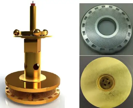

Here's a rendering and photo of a recent version of the Washington apparatus, from Lee et al. (2020):
torsion pendulum and discs
On the top right is one of the test masses, with 18 rectangular "outer negative masses" and 120 wedge-shaped "inner negative masses." On the left is the torsion pendulum. The vertical gap between the two discs is varied between $3000\text{–}50\rm\,\mu m$. Gravity makes the hanging disc twist so that the positive-mass chunks between the holes line up with each other. This is exactly the same, mathematically, as having the negative-mass holes attract each other, and/or having the positive and negative masses repel.
