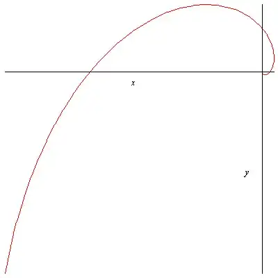

The first equation has general solution $$r(t) = A \sinh (\Omega t) + B \cosh (\Omega t)$$
Let us assume that the ball is at rest in the tube at $t=0$ at distance $r_0>0$ from the axis.
As a consequence, $r_0 = B$ and $0=\frac{dr}{dt}(0)= A\Omega$ so that $A=0$. The solution is $$r(t) = r_0 \cosh(\Omega t)\:.$$ The force due to the tube on the ball is $\phi \vec{e}_\theta$ with $$\phi(t) = 2mr_0\Omega^2 \sinh(\Omega t) \:.$$
In Cartesian coordinates centered on the rotational axis with $z$ parallel to it, the (curved) trajectory has therefore the form $$\vec{x}(t) = r_0 \cosh(\Omega t) \cos(\Omega t) \vec{e}_x + r_0 \cosh(\Omega t) \sin(\Omega t) \vec{e}_y\:. $$

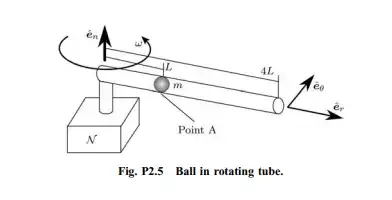

enter image description here due to the rotation of the tube, you obtain two forces on the mass
the centrifugal force
$$F_r=m\omega^2\,r\,\hat{\mathbf{e}}_r$$
and the coriolis force
$$F_\theta=-2\,m\omega\,\dot{r}\,\hat{\mathbf{e}}_\theta$$
from here the EOM
$$m\,\ddot r=F_r$$
the solution $~r(t)~$ with the initial conditions $~r(0)=L~,\dot r(0)=0~$ is
$$r(t)=\frac L2\,(e^{\omega\,t} +e^{-\omega\,t})$$
the path of the mass in inertial system is:
$$x=\cos(\omega\,t)\,r(t)\quad, y=\sin(\omega\,t)\,r(t)$$
