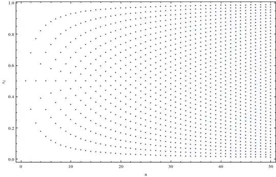

This is a more down-to-earth answer as opposed to the fancy mathematics in the other one. This problem is easily solved numerically. The equations are easily stated: inverse-square forces to the right from the particles to the left and to the left from the particles to the right. Thus, for a system of $n+2$ charges where the first and last are fixed at $x=0$ and $x=L$ by external forces (to prevent the whole system from flying apart), the positions $x_1,\ldots,x_n$ of the middle particles obey $$ \frac1{x_i^2}+\sum_{j=1}^{i-1}\frac1{(x_i-x_j)^2}-\sum_{j=i+1}^n\frac1{(x_i-x_j)^2}-\frac1{(x_i-L)^2}=0,\ \ i=1,\ldots,n. $$
This can be solved numerically to give the positions. This is a plot of the particle positions for $n$ from 1 through 50:

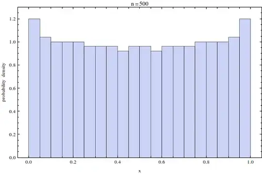

The distribution is relatively close to uniform but it is not so exactly. This is evident from the slight bunching up at the ends, and can be seen more clearly in the probability density for the positions at large $n$:

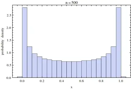

I should note that this sort of distribution is more or less what you'd expect from the zeros of a large-order orthogonal polynomial, though the Jacobi case is even more bunched up at the edges:
(Though actually the two histograms are so different, and the Coulomb one is so uniform, I'm starting to doubt whether there does exist a Calogero electrostatic model for an inverse-distance interaction potential.)
