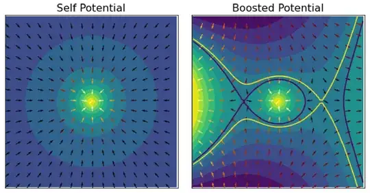

As I mentioned above, subhalos exist inside groups. There are tidal forces exerted by the group and by other objects within the group. These forces reduce the energy threshold needed to escape. One nice way to visualize this is to think about the boosted potential: boosted potential Gadget-4 is considering only the self-potential (left). $E>0$ is the criterion to escape the self-potential, which is calculated based on the subhalo's mass alone. The boosted potential is calculated based on both the subhalo and its environment, but it's transformed ("boosted") into the subhalo's accelerated reference frame. Here it can be seen that a particle only needs to exceed the energy associated with the purple contour to escape toward the center of the group or the yellow contour to escape away from it.
Also, the subhalo changes over time. If it is the central subhalo of the group, it likely accretes material, deepening its potential over time. As a result, particles that were deemed to be unbound at some point might become bound later. If it is a satellite subhalo, it loses material over time due to tidal forces. Particles that were deemed to be bound at some point would become unbound later. In principle, none of a satellite's material is bound over sufficiently long time scales.
