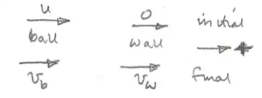

An approximation which is often made, eg molecules in a box when deriving the gas law, is that when an object rebounds elastically off a much more massive / immovable object the speed of rebound is equal to the speed of approach.
This is an approximation as shown below.
Momentum conservation: $m_{\rm b}u+0=m_{\rm b}v_{\rm b}+m_{\rm w} v_{\rm w}$
Kinetic energy conservation: u = v_{\rm w} - v_{\rm b}$
(relative velocity of approach = relative velocity of separation)
$\Rightarrow v_{\rm b}= -\dfrac {m_{\rm w}-m_{\rm b}}{m_{\rm w}+m_{\rm b}} u$
Note that if $m_{\rm w} \gg m_{\rm b}$ then $v_{\rm b} =-\dfrac {m_{\rm w}-m_{\rm b}}{m_{\rm w}+m_{\rm b}} u \to u$
