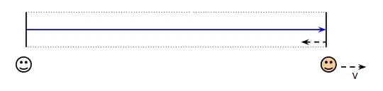

Let's have a look at your experiment:
Box
The diagram shows your box with the mirrors at each end. The white smiley is you in the rest frame of the box, and the red shifted smiley is an unconstrained observer. Due to the expansion of spacetime the red shifted observer is receding from you at a speed $v$ given by the usual Hubble law:
$$ v = H_0 l $$
where $l$ is the length of the box. However, and this is the key point, the end of your box is not receding from you because the electromagnetic forces that keep it in shape overcome the cosmological expansion.
You emit a photon of light with some well defined frequency $f_0$. When the red shifted observer measures the frequency of the light they find a frequency $f < f_0$, which is exactly what we mean by the cosmological red shift. However from the red shifted observer's point of view the mirror at the end of the box is moving with a velocity $H_0 l$, so when the photon reflects off it the distant observer sees the light is blue shifted. The result of the blue shift is that when you receive the reflected photon its frequency is unchanged i.e. there has been no (net) red shift.
