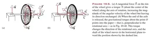

In many demonstrations of analysis of gyroscopic precession, the analysis goes on by choosing two axes, one about which angular momentum is calculated, another about which torque of gravity is considered.
For example: consider a precessing supported on a block. Angular momentum about the rod connecting the block and the centre of the wheel is in radial direction, however the torque of gravity in this axis is 0, as it passes through centre of mass. If the line perpendicular to block and through point of attachment to block is taken as axis, torque of gravity is constant, but angular momentum is variable.
Reference:enter image description here Note that the author takes angular momentum about the axis, but torque about the point $O$. The torque about the axis is $0$
How do we correctly choose the axes then?
