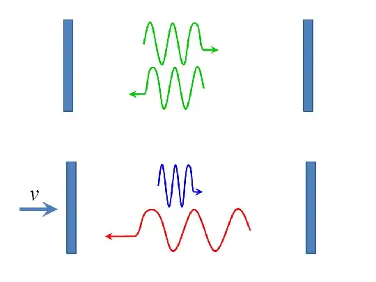

We ask what happens when we put energy inside a box.
Modern physics tends to think of everything - matter and energy as "stuff of the universe", the amount of "stuff" in a system is its total energy content, and "stuff" with a total energy $E$ always has the same mass $m$ given by $\frac{E}{c^2}$: mass is a particular property of "stuff" that defines (i) how it responds to force (i.e. its inertia) and (ii) how it affects and is affected by gravitational fields. These two masses are equal, by the Eötvös experiment and the equivalence principle of general relativity.
So, for instance, consider a photon, a normally "massless" particle (i.e. it has zero rest mass, which also means it is always moving at speed $c$). Now we trap it in a perfect, weighless resonant cavity.
Photon in a Box
At first we are at rest with respect to the cavity and there is light trapped within(easiest to think of it as a standing wave photon, but the reasoning applies to a general waveform). Then, at $t=0$, we shove the cavity, instantly increasing its velocity from nought to $v$ metres per second rightwards, and then keep pushing at constant velocity. Of course, the light is blue shifted by the left hand mirror and red shifted by the right hand mirror. There is in general a complicated sequence of collisions, but what you find is this: the total impulse needed to achieve a steady velocity of $v$ is $E v / c^2$. In other words, the system has an inertia given by $E / c^2$.
You can do the analysis by (i) thinking of one photon in the box, calculating the Doppler shift at either end and then finding the difference between the red and blue photon momentums by the standard formula $h\,\nu/c$, or (ii) you can do the full classical calculation by applying the Lorentz transformation to the electromagnetic field tensor and working out how the left-to-right and right-to-left fields transform. In the second calculation, the system takes some time to reach steady state, but the total impulse required is still $E v / c^2$.
So, by confining the photon, you give it "rest mass" - the photon's energy manifests its inertia by being confined in a box.
