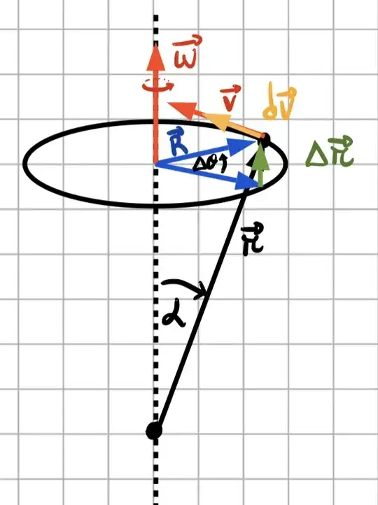

In terms of magnitude is $$\omega=\frac{d\theta}{dt}=\lim_{\Delta t\rightarrow 0}\frac{\theta(t+\Delta t)-\theta(t)}{\Delta t}=\frac{v}{R}$$
In vectorial terms $$\vec{v}=\vec{\omega} \times \vec{r}$$ $$|\vec{v}|=|\vec{\omega} \times \vec{r}|=\omega r \sin{\alpha}=\omega R$$ the result doesn't depend on the origin of $\vec{r}$ as long as is chosen along the rotation axis.
Then, because the relative velocity between any 2 points in the rigid body is null all the points are rotating around the same axis with the same angular velocity.
Deriving the velocity vector using the Leibniz rule $$\frac{\partial \vec{v}}{\partial t}=\frac{\partial }{\partial t}(|\vec{v}|\hat{v})=\frac{\partial |\vec{v}|}{\partial t}\hat{v}+|\vec{v}|\frac{\partial \hat{v}}{\partial t}$$ You get two terms: the first one is the tangential velocity $\frac{\partial |\vec{v}|}{\partial t}$ directed in the velocity (tangential) direction while the second term is the modulus of the velocity times the derivative of the velocity versor. Then, deriving the versor you get $$\frac{\partial \hat{v}}{\partial t}=\frac{\partial \theta}{\partial t}\hat{n}$$, where $\hat{n}$ is the normal vector (with respect to the tangential one). Thus, collecting the results for the second term you get $|\vec{v}|\frac{\partial \hat{v}}{\partial t}=|\vec{v}|\frac{\partial \theta}{\partial t}\hat{n}=v\omega\hat{n}=\omega^2R\hat{n}$.
Finally $$\vec{a}=\vec{a_t}+\vec{a_n}=\frac{\partial |\vec{v}|}{\partial t}\hat{v}+\omega^2R\hat{n}$$

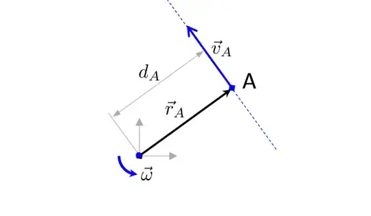

Now if you are asking about the meaning of (1), it is exactly the cross-product that provides the perpendicular distance between the origin and moving point
fig1
such that speed $ \| \vec{v}_A \| = d_A \| \vec{\omega} \| $ is the magnitude of rotation times the distance.
