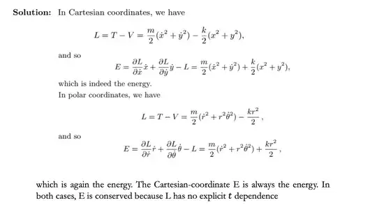

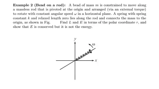

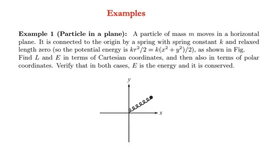

These two similar situations with slight variations are being introduced, I am not able to understand the reasoning provided as to why the quantity $E$ is equal to total energy in one and not in the other.

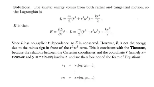

I am not able to understand how the minus sign before $r^2ω^2$ implies that the conserved quantity is not total energy as stated in the last slide.
