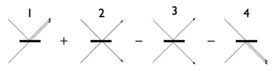

HOM is a two-photon interference effect where temporally overlapped identical photons coming perpendicular to a beam splitter must leave it in the same direction.
How is momentum conserved in this process? Initially, the total momentum of the photons is only on the x-axis, but after the beam splitter, it has a y-axis component.
Does some momentum pass to the beam splitter itself?
