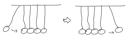

I have a question about a Newton's cradle type collision, but it has a twist to it. First, I will describe two well-known results, and then I'll add my twist.
First, consider a cradle with five balls (all of equal mass and size), and I move the leftmost ball up and release it. It strikes the row of balls and by conservation of KE (assuming this is an elastic collision) and momentum, the rightmost ball comes out swinging outwards. See picture below.

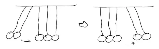

Second, consider the same setup, and I move the two leftmost balls up and release them together. They strike the row of balls and by conservation of KE (assuming this is an elastic collision) and momentum, the two rightmost balls come out swinging outwards together. See picture below.

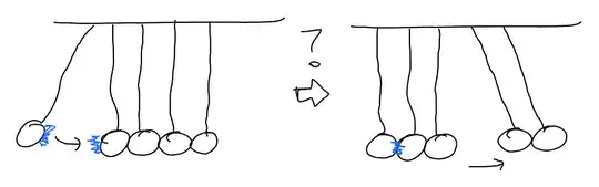

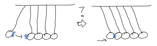

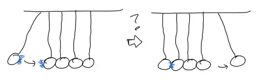

Ok, now here is my twist. Suppose I lift the leftmost ball up, but now I add highly quick-acting adhesive glue to the ball so that it sticks to anything it touches. I release the ball and it hits the row of balls. My question is, how many balls should come out swinging on the other end and at what initial velocity? See images below for a rough depiction. (Note that no other balls on the right end have any glue introduced.)

Here are a couple of possible answers and their reasonings:
  1. Answer 1: One ball comes out with the same velocity. Since the leftmost ball hits the row of balls and it doesn't ever bounce off, the scenario is identical to that of the one without any glue. If you couldn't see the glue, you wouldn't be able to tell the difference, because in either case the initial ball doesn't bounce or anything, and both KE and momentum are transferred to the rightmost end as usual. This scenario is identical to that of releasing one ball from the left, so one ball comes out from the right.
  2. Answer 2: Two balls come out with half the velocity. We can imagine that when ball #1 (the initial leftmost one) strikes ball #2 (the second leftmost one), they combine and an inelastic collision occurs. This means we go from $(m_{1}, v_{1}) = (m, v)$ and $(m_{2}, v_{2}) = (m, 0)$ to $(m_{\text{combined}}, v_{\text{combined}}) = (2m, v/2)$. Momentum is preserved but KE is lost (because an inelastic collision occurs), and thus we now have two balls together impacting the row. Afterwards, everything as in a normal Newton's cradle would happen. Thus, this scenario is identical to that of releasing two balls from the left, so two balls come out from the right (albeit with half the velocity together).
  3. Answer 3: None of the others because it depends on the specifics like the glue type. Maybe the answer varies based on further details of the setup. Maybe you get a different answer if you are using glue vs using velcro vs using cold welding (in vacuum in space) vs who knows what. Maybe it depends on the specific sequence of events that takes place in the narrow time interval of nanoseconds, and maybe the result changes each trial or something.
  4. Answer 4: None of the others but it doesn't depend on further specifics. Maybe something weird like the rightmost two balls are launched, but they are launched with different velocities, and this result is independent of further details like glue type, ball material, collision time, etc.
  5. Answer 5: All the balls will swing in unison with one-fifth of the original velocity. The "fast-acting" glue creates an inelastic collision, but there is no reason it would reduce the kinetic energy by half only. In fact, it would lead to a maximally inelastic collision, and the only way to obtain this while conserving momentum is to have all the balls swing with velocity $v/5$ together with mass $5m$.
Initially, it seemed like Answer 1 and Answer 2 were equally plausible to me, but now Answer 5 seems the most likely. How do we decide which of the these is correct? I am intending to do this experiment myself in the future, but I am curious if anyone knows how to analyze it and make an accurate prediction ahead of time. Does anyone have any thoughts?

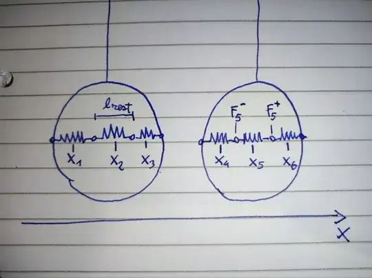

I modeled each sphere as an array of identical springs with very high elastic constant to emulate the elasticity of the metal. Each spring is attached to the ones adjacent to it, unless they belong to a different sphere, as shown in the first figure.
a description of the setup
$N_b$ is the number of metal spheres and $N_s$ is the number of springs contained in a sphere. The equation of motion for the position of the center of mass of the spring $i$ is
$\frac{d^2 x_i}{dt^2} = F_i^+ - F_i^- - K_p(x_i-x_i^{\rm rest})$
For $i$ that goes from 1 to $N_b \times N_s$. Here $F_i^+$ and $F_i^-$ are the forces that act on either side of the spring.
The term $K_p(x_i-x_i^{\rm rest})$ is instead emulating the fact that the spheres are suspended in a pendulum. Each spring will have a rest position $x_i^{\rm rest}$, determined by where it is hanged, and will try to swing back there if moved away from it. Here I am exploiting the fact that for small oscillations a pendulum is close to an harmonic oscillator. For the sake of simplicity in this way I am assuming all the springs are individually attached to a pendulum, while in reality it is only maybe the central one, but this doesn't really make any difference for what we are concerned.
Now, if the rest length of the springs is $l_{\rm rest}$, the forces acting on the springs will be
$F_i^+ = F_{i+1}^- = K_s(x_{i+1}-x_i-l_{\rm rest})$
Unless, if the two strings are not attached (e.g. because they belong to different spheres) and $x_{i+1}-x_i-l_{\rm rest} \ge 0$, then $F_i^+ = F_{i+1}^- = 0$, meaning that the two spheres are not touching at the moment.
$K_s$ is the elastic constant (divided by the mass) of the springs that constitute the metal spheres. Since the metal is very rigid, it is important that $K_s \gg K_p$.

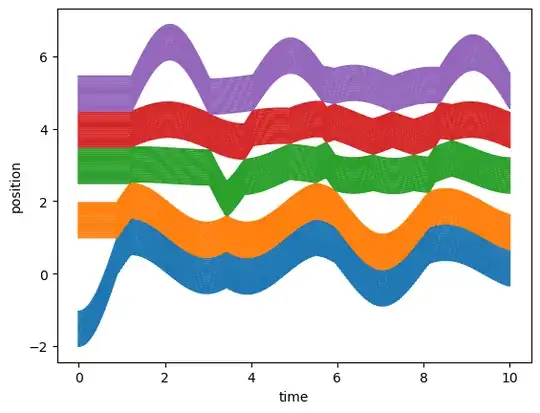

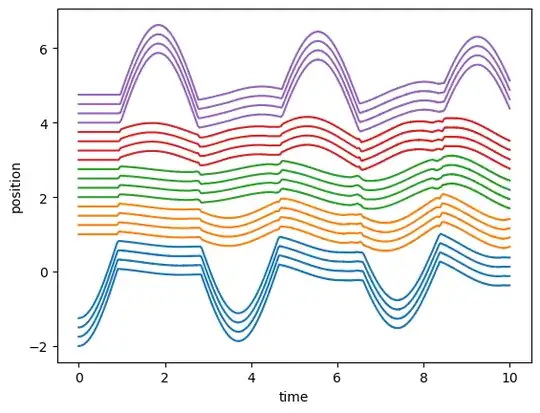

Let's look at what happens with this setup, with $N_b=5$ and $N_s=4$.
newton's cradle with 5 spheres and 4 springs per sphere
In this plot I am showing the position of center of mass of each spring $x_i$ as a function of time. Each line corresponds to one spring and they are colored base on which sphere they belong to. Initially, all the spheres are at rest except the blue one, which as been moved a bit. Once released, it swings back to its rest position and hits the others at $t \approx 1$. Then the blue one stops and most of the motion is transferred to the purple one, as expected for a Newton's cradle. Notice however that also the red one is moving a bit, and the blue one has an almost imperceptible recoil. This is not a problem with the simulation; all these effects are really present in real Newton's cradles, for instance here. I was quite satisfied when I saw this :)

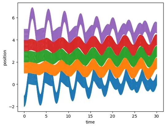

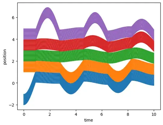

If I increase the number of springs things get even more interesting, here is what happens with 20 springs per sphere. Since each spring is now representing a smaller amount of mass, I increase $K_s$ proportionally to the number of springs, so that the overall elasticity of the spheres is kept constant.
newton's cradle with 5 spheres and 20 springs per sphere

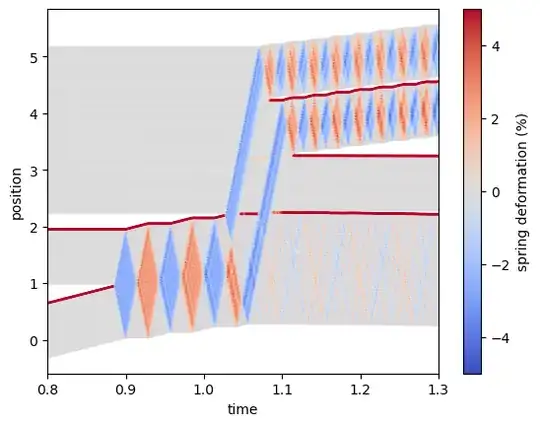

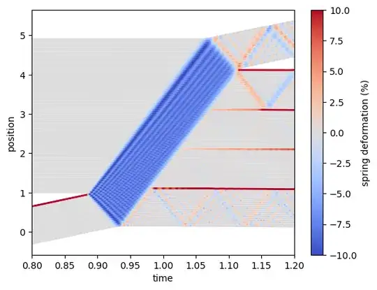

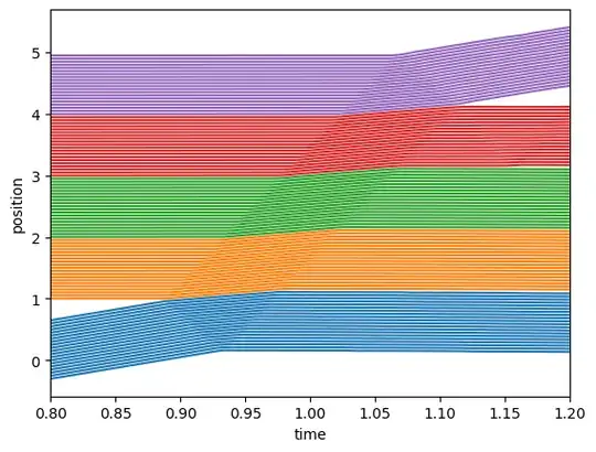

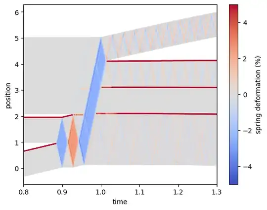

If you'll allow me a small digression, we can zoom in the region of the first collision to see what is happening there.
zoom in the collision region
After the spheres touch, there is a brief time in which all the five spheres are in contact, and then the purple one detaches.
Disclaimer: while most things in this simulation don't change much if I change the number of springs, the duration of the contact phase is not one of those. I experimented with different numbers of springs and observed that the more springs I put, the longer is the contact phase.
It's even cooler if I color-code this plot according to the spring deformation $(x_{i+1}-x_i-l_{\rm rest})/l_{\rm rest}$
zoom in the collision region color coded with spring deformation
Here you can see how much each spring is deformed. Blue means it's compressed, while red means it's extended. I think it's quite cool to see all the sound waves propagating in the metal.

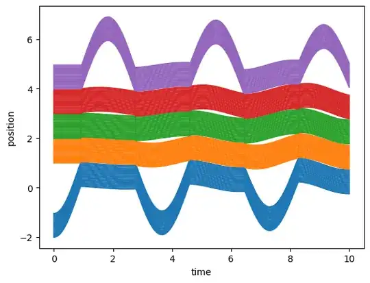

What happens if two spheres are glued together?
To figure this out we need a practical definition of what it means to glue two spheres. Someone in the comments argued that the glue may deform during the impact and dissipate energy that way, but for the moment I will take a very simple definition. As soon as the blue sphere and the orange sphere touch, the two springs become attached, as if the two spheres had become a single piece of metal. Just that, the simplest kind of inelastic collision.

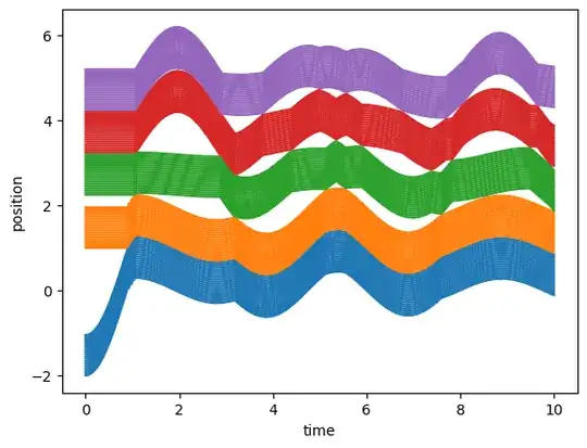

Under this simple assumption, I ran the simulation and this is the result.
newton's cradle with glue
Only the purple sphere is kicked. This seems to favor Answer 1. Interestingly, it seems like in the following collisions also the red sphere starts to be excited, but if I let the simulation run for longer to see what happens:

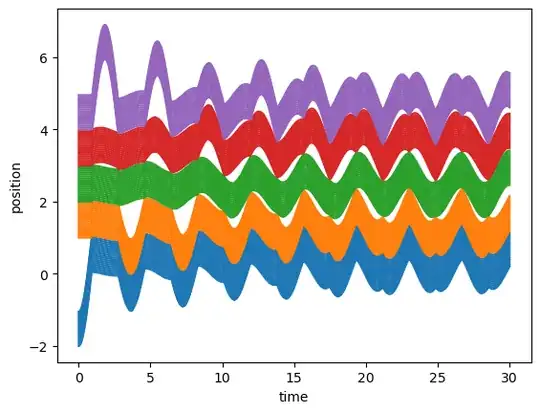

same as previous, but for a longer time
The situation descends rapidly into chaos, after which all the five spheres start oscillating together, like it sometimes happens with real Newton's cradles. For comparison, here's the same plot, but without glue

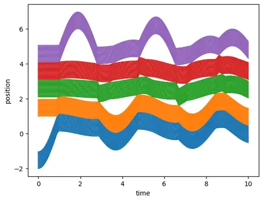

same as previous, but without glue
From the tests I made, it seems to be possible to delay the insurgence of chaos by increasing $K_s$, at the cost of an increased computational cost. All these tiny vibrating springs act in a way similar to the vibrating atoms in the metal. Even though the equations I am using conserve energy perfectly, the energy tends to move from kinetic energy of the spheres to incoherent thermal vibrations of the springs (that's the second law of thermodynamics in action, yo!). My intuition is that increasing $K_s$ I am making it harder for the springs to vibrate, and thus slowing down the inevitable increase of entropy.
One last experiment before concluding this already long answer. What happens if there is a small gap between the orange sphere and the green sphere? If they are not touching from the start, but there is some space between them, after the blue sphere hits the orange and becomes glued to it, orange and blue would move together for a brief time, and hit together the green one. And we know that in Newton's cradle, if two spheres hit, then two spheres are kicked. But, interestingly, we just saw that if there is no gap, then only one sphere is kicked out. The question is: is a tiny gap sufficient to subvert this conclusion?
The result is very interesting. I tried different gaps between orange and green. The next figure is obtained with a very small gap of 1/10 of the diameter of a sphere.
gap: 1/10
The result is similar as if there were no gap: one sphere is kicked. But if we increase the gap to 1/4, everything changes.
gap: 1/4
Here two spheres are kicked! Maybe there is a minimum gap size after which the cradle behaves as if two spheres had been put in motion. But another surprise awaits: if we increase the gap even more, to 1/2 of the sphere diameter we are back again at kicking out only one sphere!
gap: 1/2
To understand what's going on, it's useful to zoom in at the impact region, and look at the spring deformation.
First, the case with 1/10 gap:
resonance 1/10
When the blue and orange spheres are glued, there's some strong oscillation going on inside. And the oscillation seems to be in phase at the time of the collision with the green sphere. The result is a strong pulse of pressure waves that traverse the other spheres and kicks the purple one.
resonance 1/4
In case of gap 1/4 instead, the oscillations are not in phase with the time of collision with the green sphere. The result is a kick to the purple sphere, that only uses about half of the elastic energy. The rest of the energy does another oscillation inside the blue and orange sphere and is then released to kick the red sphere.
So in the end it looks like the result is very sensitive to the geometry of the system, the sound speed and whether the pressure waves are in phase or not at the time of the collisions.

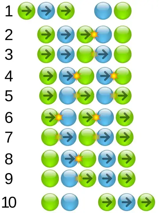

Newton's cradle is probably the simplest, yet most overlooked idea in classical mechanics.
If two balls are released with velocity v, it results in two balls coming out with the same velocity on the right. Right? But Why?
Why not just a single ball came out with velocity 2v?
Things become much easier to imagine if you consider that there are small gaps between the balls. I know this has been repeated over a thousand times already, but an image can speak a thousand words.
Image credits: Wikipedia
Without glue case: The first ball moves with velocity v and hits second ball, transfers momentum completely and comes to rest. The second ball now moves with velocity v and hits third ball, transfers momentum and comes to rest. The process goes on till last ball, which moves outward with velocity v with no one to hit next.
If you have two balls initially moving with velocity v, you can imagine a cascade of momentum transfers, where the momentum travels one ball at a time towards the right, until the two balls at the right end have velocity v.
With glue case:
The first ball moves with velocity v, and hits the second ball. Both balls now move together with velocity v/2. These two balls are now like a single object of mass 2m. This object hits the third ball, and imparts it a velocity of 2v/6. But here, the object doesn't come to rest as in before cases. It moves back with v/6 speed. This causes more complications, as after the first instant, this object will swing back and cause further collisions. So to keep things simple, we can predict that immediate result of the glued case is this:
The last ball moves out with velocity 2v/6.
This third ball hits the fourth ball and comes to rest, and so on.
The exact dynamics will depend on the ratio of propagation time of the momentum from left to right and the time it takes for the object to oscillate back and cause further collisions.
