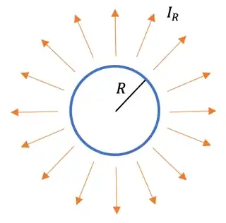

The radiative transfer equation in 1D spherical coordinates without emission and scattering and a homogeneous medium is given by $$+\mu \frac{\partial I(r, +\mu)}{\partial r} + \frac{1 - \mu^2}{r} \frac{\partial I(r, +\mu)}{\partial \mu} + \rho \kappa I(r, +\mu) = 0,$$ $$-\mu \frac{\partial I(r, -\mu)}{\partial r} - \frac{1 - \mu^2}{r} \frac{\partial I(r, -\mu)}{\partial \mu} + \rho \kappa I(r, -\mu) = 0,$$ where $r > R$ and $0 \le \mu \le 1$. The boundary conditions are $I(R, +\mu) = \frac{\delta(\mu - 1)}{2\pi} I_R$ and $I(\infty, -\mu) = 0$. The second boundary condition means that $I(r, -\mu) \equiv 0$ since there is no emission or scattering term, so I only need to worry about the first equation and the first boundary condition. This problem describes a sphere radiating a constant intensity $I_R$ in the radial direction only. Since the medium is homogeneous, the density $\rho$ and opacity $\kappa$ are constant. I drew the radiator below.
I want to solve this problem for $I(r, +\mu)$ and compute the energy density, which is given by $$u(r) = \frac{2 \pi}{c} \int_0^1 I(r, +\mu) \, d\mu,$$ where $c$ is the speed of light. I feel like the answer should be $$u(r) = a \frac{e^{-\rho \kappa r}}{r^2},$$ where $a$ is a constant, but I'm having trouble getting there. Is this answer correct? How do I compute it?
