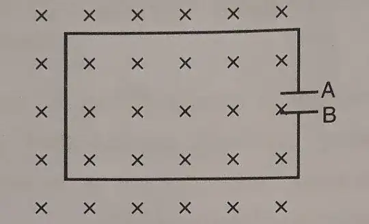

In a setup like the one show in the figure:
Will there be an induced EMF across the loop(given that the field is increasing)?
(my dilemma is : since the loop is not complete, we cannot define the flux through it.)
Is it valid to define Flux for an incomplete loop?

Yes.
What will happen is that an emf will induced in a complete loop which consists of a part of the complete loop shown with full lines and another part of the complete loop defined by a dotted line (indicating that it is not a conductor) between the plates of the capacitor.
The electric field due to the induced emf will then move mobile charge carriers so that the capacitor becomes charged until such a time as the electric field due the charges on the plates of the capacitor, is equal in magnitude but opposite in direction to, the induced electric field produced by the changing magnetic flux through the loop.
Then the mobile charge carriers will cease to move because the net force on them due to the two opposing electric fields is zero.
