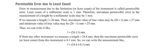

2.) Equal to least count : In some textbooks it is written that a measurement has a error equal to least count of scale ( Understanding Physics for JEE Main and Advanced Mechanics Part 1 page 19 )
  1. Half of least count : Some users like @EricTowers assume that error in a measurement is half of the least count as if they look at a measurement let's say 8.6cm they take it in interval of (8.55cm to 8.65cm] assuming error is ±0.05cm ( half of least count.1cm)
