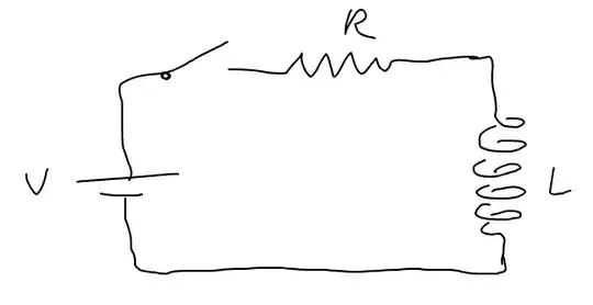

Consider an RL circuit as depicted below.

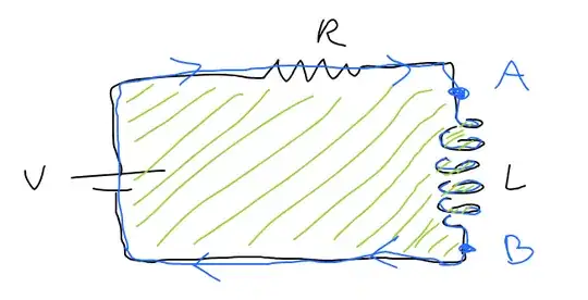

Suppose I want to apply Faraday's law ($\oint \vec{E}\cdot d\vec{l} = -\dot{\Phi}_{B}$) to find the equation governing the current of the setup. One way to do this is to take a loop going clockwise along the wire itself. Call this loop 1. See the image below for an attempt to sketch it along with the surface that goes with it.
As you go along the loop, the total electric field is only present in the battery and resistor (the inductor consists of an ideal conductive wire so there is no electric field there): $\oint_{\text{loop 1}} \vec{E}\cdot d\vec{l} = -V + IR$. On the other hand, $-\dot{\Phi}_{B} = -L\dot{I}$ due to the magnetic field in the inductor solenoid. Thus we get $-V + IR = -L\dot{I}$ or rather $-V + IR + L\dot{I} = 0$.

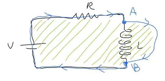

Now take a loop identical to the previous one except it takes a detour to avoid the inductor coil. Call it loop 2 and see the image below.

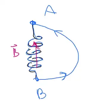

My chosen surface is now completely flat, and it cuts halfway through the inductor solenoid. Given that the magnetic field is never perpendicular to the flat surface, we have $-\dot{\Phi}_{B} = 0$. The inductor term no longer appears in the magnetic flux integral. However, the inductor term should now appear in the electric field loop integral for the following reason: Take the piece of the path going along the inductor coils and paste it with the (reverse of) the piece of the detour path. See the image below.
For a changing current through the solenoid, there should be a changing magnetic field and this means the associated surface will have $-\dot{\Phi}_{B} = -L\dot{I}$. However by Faraday's law this must equal $\oint \vec{E}\cdot d\vec{l}$ which in this case is $$ \underbrace{\int_{A\rightarrow B\text{ by inductor}} \vec{E}\cdot d\vec{l}}_{\text{this is } 0} + \int_{B\rightarrow A\text{ by detour}} \vec{E}\cdot d\vec{l}. $$ Thus $$ \int_{B\rightarrow A\text{ by detour}} \vec{E}\cdot d\vec{l} = -L\dot{I} $$ and $$ \int_{A\rightarrow B\text{ by detour}} \vec{E}\cdot d\vec{l} = +L\dot{I}. $$ Therefore, when we go back to image #3, we should find $$ \oint_{\text{loop 2}} \vec{E}\cdot d\vec{l} = -V + IR + L\dot{I} = 0. $$ This shows there must be an electric field around the inductor and it must contribute to the detour part of loop 2.

but as far as I understand the $E$-field around the solenoid has to be azimuthal around the solenoid, so it will always be perpendicular to the "detour path."
This is not the case. Total electric field $\mathbf E$ can be expressed as sum of two components:
$$ \mathbf E = \mathbf E_i + \mathbf E_C, $$
where $\mathbf E_i$ is the induced electric field due to accelerated current in the coil (this field's lines indeed go around the solenoid in circles, and are thus perpendicular to the detour path) and $\mathbf E_C$ is conservative component of the total electric field due to all charges on surface of conductors in the circuit (this field's lines go from one terminal of the inductor to the other, like electrostatic field of a dipole, so they go in similar direction as the detour path). Since $\mathbf E_C$ is conservative field, line integral of this field depends only on endpoints, not exact shape of the path, so line integral of $\mathbf E_C$ over the detour path $A\to B$ gives $L\dot{I}$, regardless of its exact shape.
