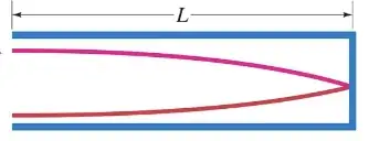

Problem 2. All diagrams I have seen, draw the antinodes tocuhing the walls of the pipe. However, I struggle to understand why this must be the case. Could I not have a small standing wave that doesn't touch the walls of the pipe. That is the yellow lines amplitude is shrunken such that they don't touch the walls of the pipe. What is limiting this? enter image description here
For example this. Here the lines do not touch the tube.

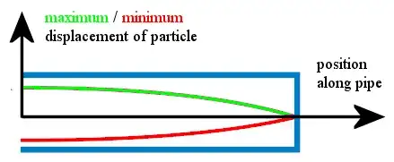

You need to read my answer to the post Why are the closed and open ends of an organ pipe nodes and anti-nodes? first to understand that those yellow lines and red lines are graphs without the axes or the corresponding labels shown.
So in your last diagram ignore the blue pipe other than it giving you an indication of where in the pipe the displacement is measured.
The vertical dimension has noting to do with the magnitude of the horizontal displacements of the particle in the tube.
The two graphs (green and red) indicate the displacements of the particles at times separated by half a period.
All you diagrams show displacements of particles and it is perhaps not surprising that a particle at a fixed end does not move as it has nowhere to go?
