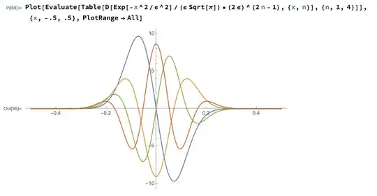

[Edit: for posterity, to answer a comment below, you can get some basic intuition by regulating the Dirac delta as, for example, the limit $\epsilon \to 0$ of Gaussians of width $\epsilon$, and just taking derivatives. You clearly get negative behavior:
Series of derivatives on Gaussian distributions
(I rescaled by powers of $2 \epsilon$ so the functions on fit on the graph).]
