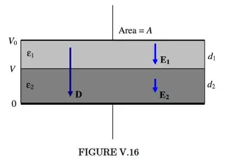

Since there seems to be no mention of dielectrics, let me add something. A capacitor figure is taken from an article by Jeremy Tatum. Jeremy Tatum figure
As you can see from the figure, for a capacitor consisting of two types of dielectrics, the electric flux density $D$ is continuous at the dielectric boundary, but the electric field $E$ is discontinuous. Since the electric charge is zero at the dielectric boundary, $\text{div}\vec{D}=0$ holds, and so on.
