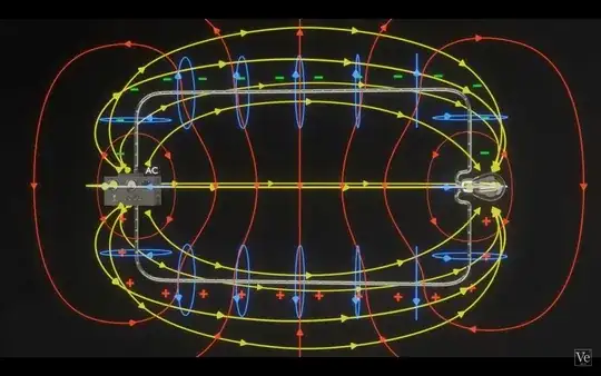

Now what I want to ask in this post is not to argue about any of the claims made during the video, as I am pretty sure he cleared a lot of them up in his follow-up video. No, what I want to ask is regarding his animation representing the electromagnetic fields around an ac circuit:
Now I am pretty sure everyone would agree that the entire field turning on and off in phase with the battery is obviously the wrong picture here since that would most definitely violate the second postulate of SR (which is literally built on electromagnetism).
We all know that the true picture is of the circuit radiating EM waves as the electric field of the battery oscillates like that of an oscillating dipole (Oscillating Dipole by John Belcher). Now my question is then how exactly would the EM waves radiate and in what direction?
