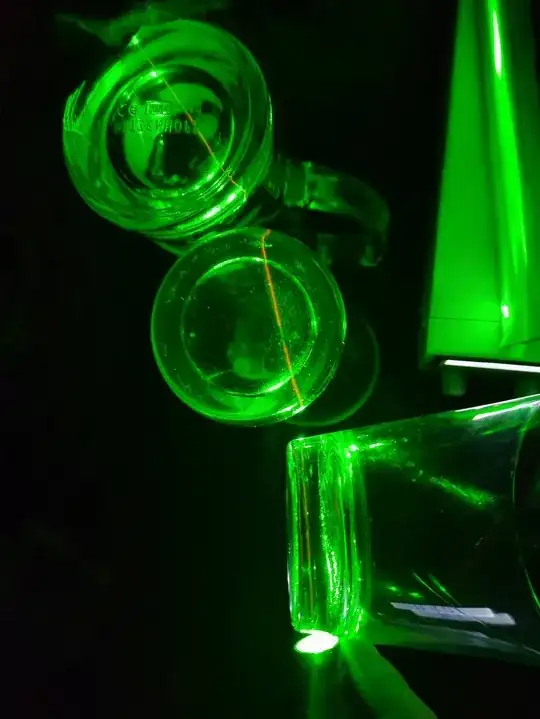

Laser cast through, in that order of transmission, the bottom of a whiskey tumbler, which actually used to be a glass candle, the bottom of a white beer glass and the bottom of a tall pilsner glass. The beam path is visible in red!

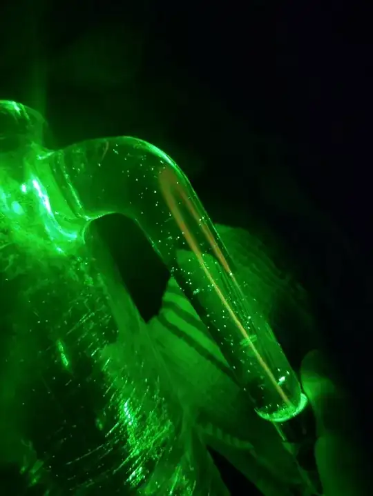

Green Laser shone into handle of glass jug; a beam of reddish light is visible following the rest emanating from the coupling point
