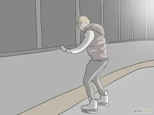

  6. pushing on a wall shoves you backwards shove off
