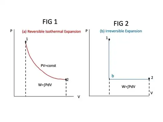

Consider a reversible vs irreversible expansion of an ideal gas in a vertically oriented cylinder fitted with a frictionless piston in a constant temperature environment. On top of the piston is a bag of sand. Initially the internal and external pressures are the same, i.e., $P_{gas}=P_{ext}$.
As an example, first consider reducing the external pressure infinitely slowly (quasi statically) by removing one grain of sand at a time, so that the gas pressure never varies significantly from the external pressure. With each removal of grain of sand the infinitesimal decrease in external gas pressure results in an infinitesimal expansion (infinitesimal amount of work) and an infinitesimal decrease in temperature. This results in an infinitesimal transfer of heat from the surroundings to the gas restoring its temperature to the initial temperature (temperature of the surroundings). The process is continued until the entire bag of sand is removed and the pressure becomes atmospheric. The result is a reversible isothermal (constant temperature) expansion. A PV diagram of the process is shown in FIG 1 below. The area under the curve is the net work done by the gas.
Now consider instead of removing one grain of sand at a time, the entire bag of sand is abruptly removed so that the external pressure quickly (non quasi-statically) drops. As in the first case, the external temperature is constant. A PV diagram of the process is shown in FIG 2. The abrupt decrease in external pressure does not permit enough time for heat to transfer to the gas and perform work. This is a lost opportunity to perform work. After the abrupt decrease in external pressure the gas expands irreversibly doing work until the gas pressure comes back into equilibrium with the constant external pressure. As shown in FIG 2 less work is done.
