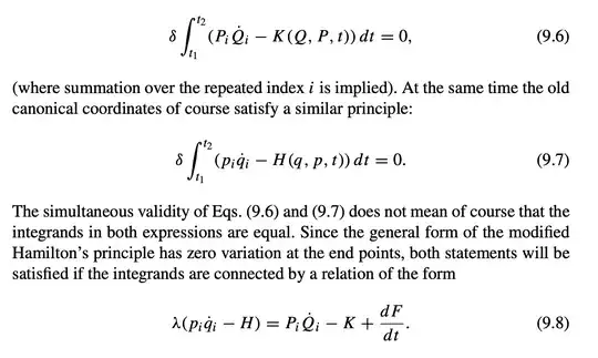

In chapter 9 of Goldstein,when talking about a canonical transformatio $(p,q,t) \to (P,Q,t)$ where Hamilton's principle is obeyed:
He mentions that (9.8) is a sufficient but not necessary condition.

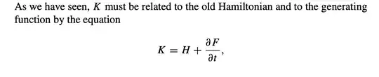

However in chapter 10 between eqs. (10.1) and (10.2) he states that
which we derived using (9.8) with $\lambda=1$. How has the sufficient condition become a necessary one?
I though the idea of (9.8) is that if the integrands are both equal it is one way to satisfy (9.6) and (9.7) but not the only way?
This is because Ref. 1. later simply declares in the text under eq. (9.11) that an canonical transformation (CT) by definition satisfies eq. (9.8) with $\lambda=1$.
For the various definitions of a canonical transformation (CT), see e.g. this Phys.SE post.
