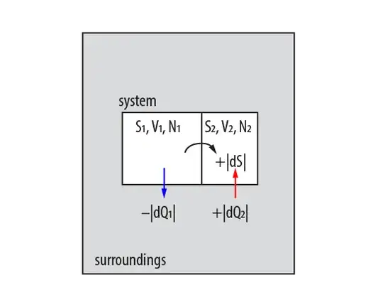

partitioned system
The system is divided into two parts, part 1 with $(S_1,V_1,N_1)$ and part 2 with $(S_2, V_2,N_2)$ such that $S_1+S_2$, $V_1+V_2$ and $N_1+N_2$ are fixed. We will exchange entropy between the two parts keeping all other variables constant. Let's say that an amount $|d S|$ is transferred from 1 to 2. We do this as follows: From system 1 we remove an amount of heat $$ |dQ_1| = T_1 |dS| $$ To system 2 we add the amount of heat $$ |dQ_2| = T_2 |dS| $$ The net effect is that entropy has moved from part 1 to part 2 with the total entropy staying the same.
The entropy generation in the universe is the sum of the entropy change in 1, plus the entropy change in 2, plus the entropy change of the bath: $$ dS_\text{gen} = -|dS| + |dS| + \frac{+|dQ_1|-|dQ_2|}{T_\text{surr}} \geq 0, $$ from which we conclude that $$ +|dQ_1|-|dQ_2| \geq 0 . $$ By first law applied to the system, noting that there is no work since volume is constant, we have $$ dU = -|dQ_1|+|dQ_2| \leq 0 $$ Conclusion The maximization of entropy in the universe (system plus surroundings) is equivalent to minimization of $U$ in the system under the condition that $S$, $V$ and $N$ of the system remain constant.
The last result we can write as $$ dU = -T_1|dS| + T_2|dS| \leq 0. $$ At equilibrium $dU=0$ because $dS_\text{gen}=0$, and since this ought to hold for any small $|dS|$, we must have $$T_1=T_2$$ Therefore, the minimization of $U$ leads to the the same criterion for thermal equilibrium as the maximization of $S$.
You can guess that that the same analysis applied to $V$ and to $N$ will yield the equilibrium conditions $P_1=P_2$ and $\mu_1=\mu_2$.
The bigger lesson The minimization of potentials should always be understood to be with respect to the partitioning of the extensive variables of the potential between parts of the system while keeping the intensive variables constant. Here, $U=U(S,V,N)$ has three extensive variables. We demonstrated the minimization of $U$ with respect to partitioning one of them, $S$. You should be able to show the same under partitioning of $V$ or $N$.
