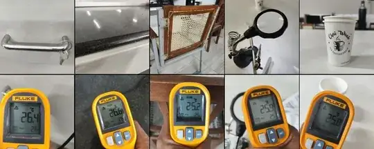

I experimented with the following materials: A steel handle, a granite slab, a wooden chair, lens from a solder stand, and a paper cup. See that the temperature of the granite slab and steel handle is in fact higher than the rest of the materials. The temperatures were measured using a Fluke 62 max IR thermometer (I don't have any associations with the company, this thing was just lying there in the lab). The feeling was measured using my forearm. The forearm was properly recalibrated after each measurement by idling for one minute.
Object Temperature ($Celsius$) How it felt Thermal conductivity($Wm^{−1} K^{−1}$)
Steel handle 26.4 Very very cool 45
Granite slab 26.6 Very cool ~3.1
Wooden chair 25.2 A little bit cold ~0.1
Solder Lens 25.9 A little bit more cold ~1
Paper cup 25.8 Warm 0.05
The following orderings were made by comparing each material in pairs.
The temperatures were roughly the same ($25.98\pm0.49^{\circ}$C) for all these objects since they exist in this air-conditioned room for as far as I remember. So the main factor contributing to the coldness here should be the thermal conductivity.
The materials ordered by thermal conductivity (high to low):
Steel>Granite>Glass>Wood>Paper
The materials ordered by how cold they feel (cool to warm):
The order of coolness seems to match nicely with the order of thermal conductivity. Note that I looked up the thermal conductivities after performing the experiment, in order to remove confirmatory biases. Bob's and Nic's answers explain well the thermal conductivity part and how coolness is related to the skin's heat transfer rate rather than actual temperature (Also see this related question).
This experiment seems to confirm that their explanations are on point.
