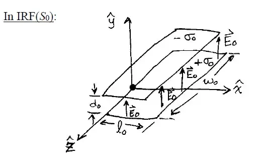

In this excellent note, Prof. Errede derives two results as to how the fields of a capacitor and of a coil transform from one inertial system to another. First I just summarize a few relevant results described there. For the capacitor: capacitor in the stationary frame
$$\vec{E}=\gamma_0 E_0\hat y \tag{1e}$$ $$\vec{B}=-\frac{\gamma_0}{c}\beta_0 E_0\hat z \tag{1b}$$
Here $E_0=\frac{V}{d_0}$ is the homogeneous field intensity between plates separated by $d_0$ and voltage drop $V$.

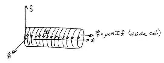

For the coil: coil in the stationary frame $$\vec{E}=0 \tag{2e}$$ $$\vec{B}=\mu_0 \mathcal {N} I \hat x \tag{2b}$$ where $\mathcal {N}$ is the number of turns per unit length.
For quasi-stationary approximation to hold, one that ignores all radiation effects, we must assume that ideally lumped circuits are point-like. In practice this means that their characteristic length must not be larger than a few percent of the free-space wavelength.

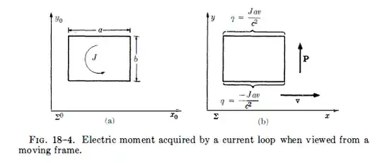

Errede's notes do not discuss the field transformation of the coil for lateral motion, but that is addressed for a single loop in Panofsky-Phillips with the result that along the perimeter of rectangular loop, 2 long and 2 short sides, carrying a current $I$ there develops a static dipole, so that one side is negatively charged the other is equally positively charged. The charge separation is within the confines the rectangular loop and the charge, and thus the dipole moment is proportional to the current. I have not been able to derive the same for a circular loop let alone for a coil but I am confident that a similar result will come about, just as I am confident that a similar development will happen if the capacitor is not a pair of planar plates but are made of a more complicated structure resulting in a magnetic field orthogonal to both the electric field inside, thus the voltage between the terminals, and to the motion.
Panofsky-Phillips, page 334
The import of all this is that both the capacitor and the coil stay lumped that is all the relativistic effects stay inside the body of the element and the effect is a linear function of the voltage and current, respectively. An engineer modeling this would say that a capacitor is to be augmented in series with a voltage controlled current source that is an inductor; while the coil is to be augmented in parallel with a current controlled voltage source that is a capacitor. All this modification is completely within the classical lumped element version of Kirchhoff's KCL and KVL.
All this must include the proviso that the free space wavelength be much larger than any of the circuit elements. Here the motion towards the observer must be taken into account because the Doppler effect shrinks the wavelength already unrelated to relativity. That is we have a limit as to how fast we can move towards the observer and still maintain quasi-stationarity.
Geometry comes into play by noticing that the relativistic effect on each element depends on said point-like element's disposition relative to the motion. In the stationary system this is completely ignored by the KCL/KVL but it shows up in the controlled sources attached to the elements.
