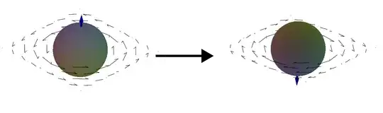

If the charge distribution has spherical symmetry, so must the electric field. You are right that the individual contributions to the E-field from the different parts of the sphere will point in all kinds of directions, but because of the spherical symmetry we know that all the "odd" directions must cancel.
Imagine if this were not the case, i.e. the E-field were not radial. Let us say that it had an azimuthal component. Now imagine that we rotate the entire charged sphere 180 degrees, so that the old north pole of our coordinate system now is the south pole as illustrated in the figure. Since the whole physical configuration has rotated, so must the field, and we notice that the azimuthal component of the field now points in the opposite direction as before. But due to the spherical symmetry of the charge distribution, nothing changed when we rotated the sphere, and we should therefore have the same electric field before and after applying the rotation. This shows that the electric field cannot have an azimuthal component, and the only remaining option is that it must be purely radial. enter image description here
