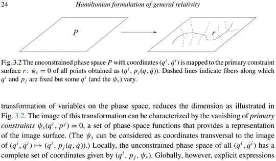

  2. Now, in the caption of the picture there is a remark about fibers away from the costraint surface on which $q^i$ and $p_{j}$ are fixed and some $\dot{q}$ and $\psi_{s}$ vary. Can someone explain this physically and possibly give examples.
I would appreciate it if someone gives an overall explanatuion/picture of what is going on geometrically (that is a map from the original $2n$ dimensional manifold $(q^i,\dot{q}^i)$ to a submanifold (the constraint surface) with lower dimension; the fibres on each point of it etc.) and justify the explanations with examples (not necessarily being limited to the one I chose).

  2. Ref. 1 uses the same notation $p_i$ for the momentum $p_i$, the regular momentum $\pi_a$ and the function $g_i$. Ref. 1 uses the notation $\psi_s$ for the primary constraint functions $\phi_{\alpha}$. The second picture in Fig. 3.2 shows the phase space with coordinates $(q^i,p_j)$. The space in the first picture of Fig. 3.2 with coordinates $(q^i,\dot{q}^j)$ mentioned in the caption is instead the tangent bundle over the configuration space.
    In other words, the caption of Fig. 3.2
    Fig. 3.2 The unconstrained $\color{red}{\text{phase space $P$}}$ with coordinates $(q^i,\dot{q}^i)$ is mapped to the primary constraint surface $r$: $\psi_s=0$ of all points obtained as $(q^i,p_j(q,\dot{q}))$. Dashed lines indicate fibers along which $q^i$ and $p_j$ are fixed but $\color{red}{\text{some $\dot{q}^i$ (and the $\psi_s$)}}$ vary.
    should be changed to
    Fig. 3.2 The unconstrained $\color{green}{\text{tangent bundle in the first picture}}$ with coordinates $(q^i,\dot{q}^i)$ is mapped to the primary constraint surface $r$: $\psi_s=0$ of all points obtained as $(q^i,p_j(q,\dot{q}))$ $\color{green}{\text{in the phase space $P$ of the second picture}}$. Dashed lines indicate fibers along which $q^i$ and $\color{green}{\text{(regular)}}$ $p_j$ are fixed but $\color{green}{\psi_s}$ vary.
