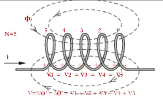

Coil

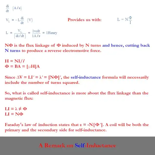

Here 5 turns (in total) induce a flux of $\phi$ which then again cuts the 5 turns. Each turn induces an EMF of $\phi'$ but since there are 5 turns, each one of them acts like a battery connected in series and sums to EMF = $5\phi'$. Here the concept of flux linkage appears, we use $\lambda=N\phi$ instead of $\phi$ and restate Faraday's law of induction as follows: $\lambda' = (N\phi)' = N(\phi') = \Delta V.$ Hence, the EMF can be directly calculated as the derivative of the flux linkage. I prepared the following (better) illustration:
Self-Inductance

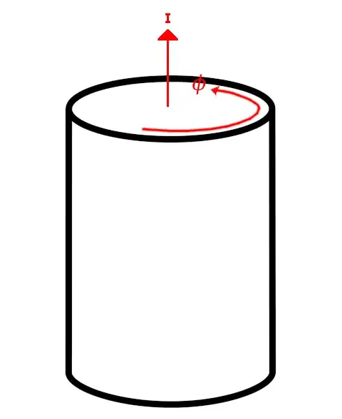

So to find the internal self-inductance of a conductor, we should calculate the flux linkage. Not flux itself. In all three questions above, OPs calculated flux spinning horizontally inside the conductor. And they did it without a mistake:
$$\phi=\frac{\mu}{8\pi}i$$
Internal Flux

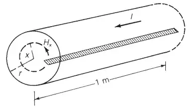

Flux Linkage inside a conducture
$$B_x = \mu I\frac{x}{2 \pi r^2}$$ $$d\phi = \mu I\frac{x}{2 \pi r^2} \times 1 \times dr$$

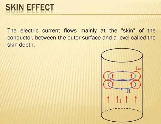

Here they are stuck. They have to find $d\lambda = Nd\phi$ after this. But how? Simple as that: We will drive a vertical circle for the horizontal flux to flow into, an artificial turn inside the conductor, containing our flux. In practice, these artificial paths of current, correspond to the eddy currents causing the skin effect:
The Skin-Effect
See that $I_w$? It will be our "turn". This turn will start from the outer edge of $B_x$ and then end in the origin. Indeed this is why current condenses on the shell of the conductor. The turn will be a circle taking $\frac{x}{2}$ as the origin.
