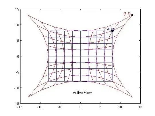

Active View
One description of the active view that is sometimes used is that points are "moved around" (in some sense perhaps it's better to think just of an association between points, "moving" implies "with respect to some background"). So in our example, we'd think of the point P as having been "stretched out" to the new location P'. (These locations are with respect to the old $x$ coordinate system). enter image description here
The old (blue) $x=$ constant coordinate lines get dragged along too, into the red lines shown in the diagram. So the point P retains its old coordinate values $(8,8)$ in its new location, i.e $(X,Y)=(8,8)$. The metric is also dragged along (see for example Lusanna) according to: $$h_{ab}(X)|_{P'} \ dX^a \otimes dX^b = g_{ab}(x)|_{P}\ dx^a \otimes dx^b \ \ \ (2)$$ So the old Euclidean metric $dx^2+dy^2$ becomes $dX^2+dY^2$, i.e. still Euclidean in the new $(X,Y)$ chart - nothing has changed. So, for example, the angle between the red vectors $\frac{\partial}{\partial X}$, $\frac{\partial}{\partial Y}$ is still 90 degrees, as it was for the blue vectors $\frac{\partial}{\partial x}$, $\frac{\partial}{\partial y}$ ! My guess is that this is what Wald means by the physical equivalence - in this example a Euclidean metric remains Euclidean.

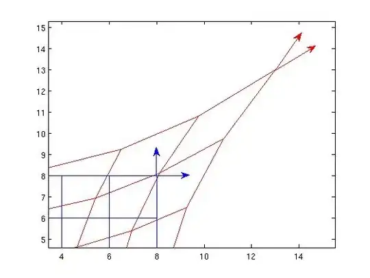

Now, if we look at the red vectors from the point of view of the blue frame, they sure don't look orthogonal*, so from the blue point of view, it can only be a new metric in which the red vectors are orthogonal. So active diffeomorphisms can be interpreted as generating new metrics.

*Just compute the vectors $\frac{\partial}{\partial X}, \frac{\partial}{\partial Y}$ in terms of $\frac{\partial}{\partial x}$, $\frac{\partial}{\partial y}$ and test their orthogonality using the original Euclidean metric.
