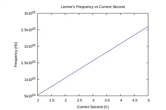

Suppose we have a current going through a circular coil and connected to itself so the current runs forever. If we want the radiation generated by such an infinite coil then we have:
$$ \nu =\frac{\sqrt{\frac{c}{{{\epsilon }_0} h}} \left| x\right| }{\sqrt{6}\, \sqrt{{\pi} }\, \left| r\right| } $$
Or: Larmor's Frequency vs Current Second
Where:
  • $a = c^2/r$ (assuming electrons travel at c)
  • $q = 1\;\mathrm{C}$ (Coulomb)
  • $h$ = Planck's constant (in Joules seconds)
This seems like a strong radiation for such a small current: EM Spectrum
How is this possible?
You're grossly overestimating the speed at which electrons travel in a wire. While the signal may travel near the speed of light, the individual charges move much slower.
