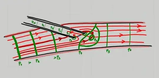

When the IV drip for a patient is completed, the patient's blood will flow back.
This is apparently due to the pressure difference.
However, IV needles are inserted into veins in the direction of blood flow.
Hence, the blood is flowing against the direction of blood flow.
Is the pressure difference so high?
Can someone explain this? A non mathematical approach is fine
Starlight
  • 347
26

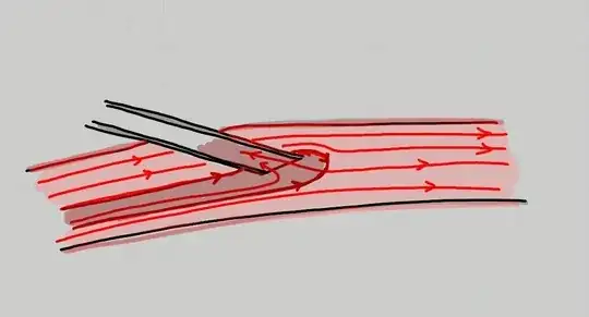

I'm not a nurse, but I think that the pressure into the vein is enough, if you see the blood flowing from the vein to the outside.
This should mean that, locally, close to the needle, a small amount of the flow changes its direction to enter the needle, while the most of it keeps flowing in the "expected" direction.
It's like you drinking with a straw from a river. No matter the direction of the straw, you can drink through it, but you're not reversing the whole flow of the river.
If I'd try a qualitative sketch of the pressure field, I'd say something like this, for the iso-contour of pressure.
