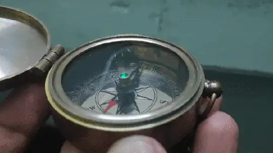

Stating the obvious here, in case anyone misses it. The compass needle is not a freely suspended magnetic dipole. It is mechanically confined to rotating in a plane. If you look at the compass needle from the side, it is suspended from the top of the hollow center cap through a pin, making it a pendulum effectively. This makes the needle align to the parallel component of the earth's magnetic field. The perpendicular component is negligible compared to the torque due to the weight of this pendulum. enter image description here
