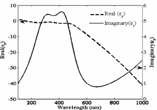

Feynman chapter 23 Refractive Index of Dense Materials in his Lectures Volume 2 explains the fact that the permittivity of a material is frequency dependent (and can be imaginary!) as is its refractive index.
Here is an example for gold which shown quite clearly that permittivity is not constant over a range of frequencies.
Source
The imaginary nature of the permittivity is a Mathematical convenience so that components of the properties of a material can be described in a compact form. The real part gives information about the speed of an electromagnetic wave through the medium and the imaginary part gives information about the attenuation of an electromagnetic wave due to energy loss as it passes through the medium.
