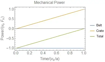

For the belt the velocity is $v_{b} \ \hat i$ and the kinetic friction force acting on the belt is $-F_{k} \ \hat i$. So the mechanical power is $P_b=-v_b \ F_k$. Since this is negative it means that mechanical power is leaving the belt at a rate of $P_b$.
For the crate the velocity is $v_c \ \hat i$ where $v_c = a t = t \ F_k/m = t \ \mu_k \ g$. On the crate the force is $F_k \ \hat i$ so the mechanical power is $P_c=v_c \ F_k = F_k \ a \ t $. Note that this is positive, meaning that mechanical power is entering the crate at a rate of $P_c$, and note further that that rate is not constant but it is increasing linearly over time.
Mechanical Power
So there is mechanical power leaving the belt at a constant rate and mechanical power entering the crate at a linearly increasing rate. Thus the total mechanical power is negative and goes to zero.
The negative total mechanical power is mechanical power that leaves the belt but does not enter the crate. That power goes to heat.
Why is the work done by the motor double of the difference in final and initial kinetic energies?
The work is the integral of the power, or the area under the curve in the plot. The difference in KE is the area of the triangle and the work done is the area of the rectangle. The triangle is half the area of the rectangle.
Friction is an internal force therefore it should not have any effect on the work done.
Whether it is internal or external is not relevant. The fact is that the total mechanical power is negative, so mechanical power is being converted to something else (heat).

The same thing happens in many other contexts. Whenever you have one constant power and one linearly increasing power then you will have a factor of 2 conversion of energy from one form to another. Links have been provided in the comments.

The “loss” of energy is due to the fact that the molecules of the belt are moving at a different velocity than the molecules of the crate. So the equal and opposite forces produce different power.
specify whether or not friction causes a transfer of energy from belt to crate
Yes, friction causes a transfer of energy from belt to crate. The amount of mechanical power leaving the belt is greater than the amount of mechanical power entering the crate.
why exactly double of the energy gained by the crate is the required work done
The area of the rectangle is exactly double the area of the triangle.
