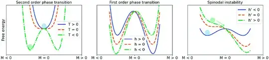

Landau theory of phase transitions considers the situations with multiple equivalent extrema. More specifically, the first order transitions correspond to the existence of a single global minimum of Landau function, which changes its position, whereas the second order phase transitions correspond to simultaneous existence of several minima, with the system being stuck in one of them - the minima then merge at the phase transition. Magnetization of a ferromagnet is a typical example, as all its directions are equivalent and all can be treated as thermodynamic equilibria (image source).
Landau function is often associated with the free energy, and if we stick to phenomenological formulation of thermodynamics (which what Callen presents here), then there is probably no way of distinguishing them. From the statistical mechanics viewpoint they are not the same, since the susceptibilities determined from a partition function always display analytical behavior (which probably could be linked to existence of a unique extremum/ground state.) One then says that states with different extrema correspond to partial sums over the phase space, where the system spends very long time - hence mentioning of ergodicity breaking in this context (the system does not visit all the microstates, and time averaging is not equivalent to the ensemble average.)
