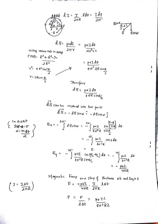

I have provided the solution in the image..See basically You are right till the Magnetic field part but You have to mention current in force part in terms of Current Per unit length as u have taken a strip here.. Hope this help
P.S. I know it is late ..4yrs you would've already figured this out P.S. This is for othere who seek this question and I dont think the average concept work here anyway.. Thanks
