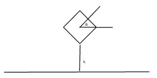

Consider a 4 sided (square) dice in a 2d universe, and think of "rolling a dice" as a statistical mechanical system in the angle of the dice and the height the dice is off the ground. enter image description here

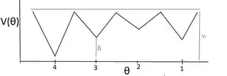

As the dice is rolled, the temperature drops over time. The potential of a biased dice as a function of angle at fixed $h$ looks like this:
So when the temperature drops below $T_0=v_0/k_B$ the dice chooses which potential well to permanently fall into, and the ratio of probabilities $P_4/P_1$ (four sided dice biased to land on $4$) is $\sim \exp(\delta/k_BT_0)=\exp(\delta/v_0)$. When we change the force of gravity, both $\delta$ and $v_0$ scale the same way (they are both proportional to $g$), so this probability ratio should remain invariant.
Obviously, this argument isn't rigorous - it's not clear that this system can be analyzed with statistical mechanics, nor that this way of treating "which potential well we fall into as temperature lowers" is really valid. But I think for the derivation of how $P_6/P_1-1$ scales with the potential difference between sides and $g$, it's valid. So I think this argument is a valid to argue that $P_6$ is at least weakly independent of $g$.
There's an obvious exception to this argument, which again argues that $g$ probably doesn't matter but the bouncing surface probably does. When you change the bouncing surface, it may change the rate at which the temperature drops. Consider for example a less bouncy surface that makes the temperature drop faster. This may lower the effective temperature at which the dice's fate is decided, increasing $P_6$.
