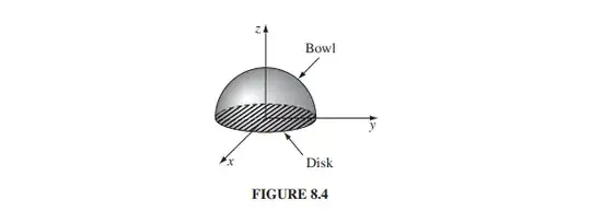

In his solution, in page 354, he argues that for the bowl, the net force is obviously in the $z$-direction, so it suffices to calculate $(\mathbf{T} \cdot d\mathbf{a})_z$ to determine $F_ {\operatorname{bowl}} = \oint_{S} \mathbf{T} \cdot d\mathbf{a}$, where $T_{ij}$ is the Maxwell stress tensor. Why this statement is true? Due to the symmetry asscociated with this problem? Can we prove this more rigorously, possibly involving some pictures ?
And he contiues to argue as follows : Meanwhile, for the equatorial disk, $d\mathbf{a} = -rdrd\phi \hat{\mathbf{z}}$ ( I also don't know why this is true ), and
$$ \mathbf{E} = \frac{1}{4\pi \epsilon_0}\frac{Q}{R^3}\mathbf{r}.$$
Why this equality is true? C.f. In his book p.353, he wrote that for the bowl, $\mathbf{E}= \frac{1}{4\pi \epsilon_0}\frac{Q}{R^2}\hat{\mathbf{r}}$. And why such formula $ \mathbf{E} = \frac{1}{4\pi \epsilon_0}\frac{Q}{R^3}\mathbf{r}$ holds for the equatorial disk? I think that I don't know some basic fact. Where can I find assoicated reference? Anyway, can anyone helps?
