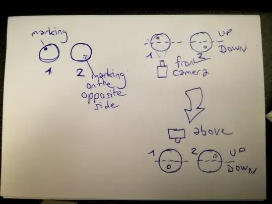

Spheres
On the above illustration, two spheres have a marking on the opposite side of each other. In the top right corner, we take a picture of sphere 1 and 2 from the front. We observe that in sphere 1 photo, the marking is in the upper half of the picture. We decide to label it as "spin up state". On sphere 2 photo, the marking is on the lower half of the picture. We label it "spin down state". So we have an anticorrelated spin state of sort.
Now, instead of taking pictures in the same axis, we take a picture of sphere 2 from above. And we observe the resulting picture has a 50% chance of returning a spin up or down state, i.e. we lost correlation.
As far as I understand, this is what happens when two particles are entangled and two detectors are set to measure their spin state. If both detectors use the same axis, one can observe that particle B has an anticorrelated spin state that the one measured on particle A. But if different axes are used for detection, the correlation is lost.
So my question is this: what makes entanglement different than the classical spheres analogy I gave above?

Now let's add some entanglement.
Suppose that whenever you measure Sphere 1 from the front and Sphere 2 from above, or vice versa, the measurements remain highly anticorrelated. However, if you measure both from the front they become almost entirely uncorrelated.
Try explaining that with a classical picture. (Hint: Bell's Theorem guarantees that you can't.)
