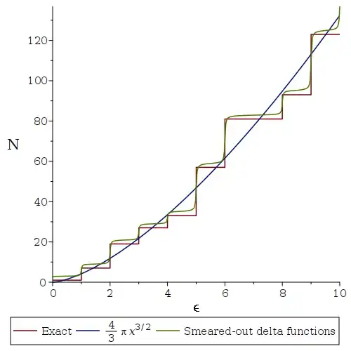

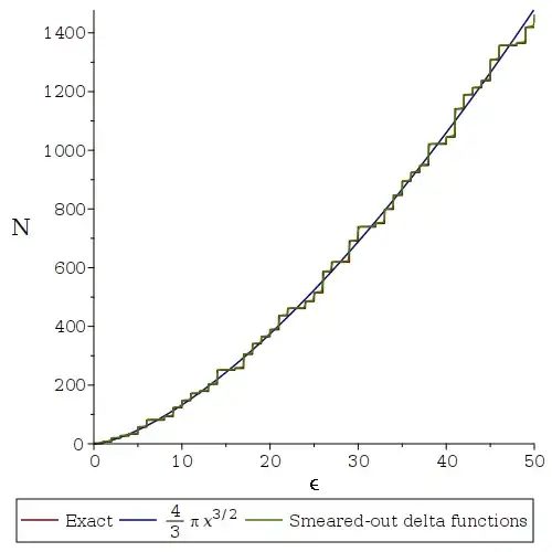

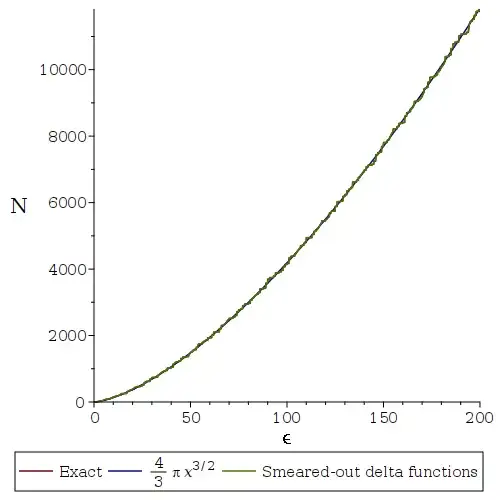

Let us do this numerically to test various continuous approximations to the DOS. I'll set $2m = 1$, $\hbar = 1$ and $L = \frac{1}{2\pi}$ to make all the annoying numerical constants drop out. Then we have $$\epsilon_k = k_x^2 + k_y^2 + k_z^2 = n_x^2 + n_y^2 + n_z^2.$$ The normal approach to approximating the density of states as a continuous function would result in $g(\epsilon) \approx 2\pi \sqrt{\epsilon}$ which would then result in $N(\epsilon) \approx \frac{4\pi}{3} \epsilon^{3/2}$. We could also make another approximation by replacing the delta-functions in the exact DOS by narrow Lorentzians $\delta(\epsilon) \approx \frac{\eta}{\pi(\epsilon^2 + \eta^2)}$ for some small $\eta$.
In the three figures below I've calculated $N(\epsilon)$ using the exact DOS and the two approximation schemes outlined above (for the smeared deltas, I set $\eta = 0.02$). The only difference between the figures is the range shown on the x- and y-axes.
From the figures it is quite clear that the ordinary continuous approximation becomes very good at large energies, when there are many contributing states, but is not so great for low energies when only a smaller number of states contributes to the sum. From this we can infer that for this system, we can safely use $g(\epsilon) \approx 2\pi \sqrt{\epsilon}$ if the main contribution to the sum comes from the multitude of states at high energies. However if a single state by itself contributes significantly to the sum, it is necessary to have a very good approximation to $g(\epsilon)$ for that particular state. If you have a macroscopically occupied state in your system, it is likely to contribute significantly by itself to any function that you are trying to calculate, and in that case the approximation you are using must take that into account.
