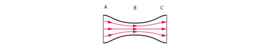

The question has been answered already but since the OP mentions the Bernoulli equation it is instructive to see how this equation actually explains flow against pressure.
Bernoulli's equation governs the motion of the fluid in the absence of frictional losses. For incompressible fluid, $$ \frac{v^2}{2} + g z + \frac{P}{\rho} = \text{const.} $$ Consider flow through a blood vessel of varying diameter, below. Constricted-vessel
Velocity is higher in the constriction because the same mass has to flow through a smaller area. Neglecting the gravitational potential, Bernoulli's equation says that the pressure at the constriction is lower than at the edges of the vessel. That is: $$P_A > P_B < P_C$$ From $B$ to $C$ the flow is against the pressure gradient. This is possible because the fluid has enough kinetic energy to overcome the opposing pressure.
