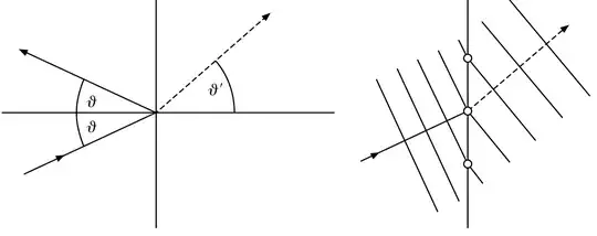

In a simple case of incidence of a plain wave on an infinite interface (please note that this is just a mathematical formulation which seems to work quite well for the majority of the usual cases) a portion of the incident energy will be transmitted to the "other side" while the rest will be reflected travelling in the opposite way but on the same axis. A simple depiction of that is shown in the following image (source: Acoustics - An Introduction by Heinrich Kuttruff).
Reflection and transmission
In the image, it is assumed that on the right of the interface, the medium is different than that on the left of the interface.
The amount of energy transmitted and consequently that being reflected, which is the former's complement to the sum of unity depends on the impedances of the two media. The greater the mismatch of the impedances, the greater the amount of energy reflected. If the incidence energy is denoted $E_{i}$ and is normalised to unity, $E_{i} = 1$, then the following equations hold

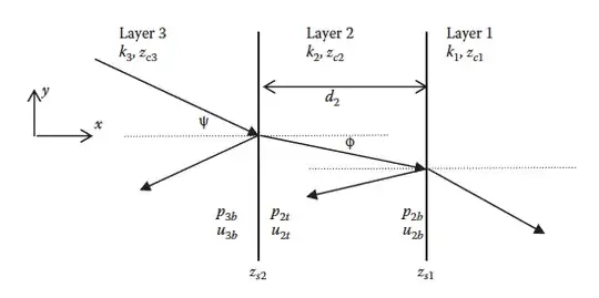

Thus we can see that transmission is mainly dictated by the impedance of the two media. To conclude our discussion on reflection and transmission I show an image depicting a closer-to-reality case (source: Acoustic Absorbers and Diffusers: Theory, Design and Application by Trevor Cox and Peter D' Antonio). If you exchange Layer 3 with the same medium as in Layer 1 you have a usual case where an absorptive panel (or other material) is placed close to the wall but not touching it (as we'll discuss below, this provides better "absorption" than when attached to the wall).

For us, as a person who wants to "get rid" of the acoustic energy completely (this is to transform it to some other kind of energy since we cannot violate energy conservation) the aforementioned approach is not adequate. For example, in the case of the second image, some of the energy passing through the supposed absorbing panel will hit the wall and return to the room (possibly by passing through the absorbing panel once more).

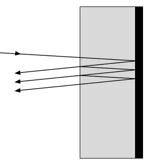

Below is a depiction of an absorptive material layer attached to a rigid (very reflective) wall (source: Acoustics - An Introduction by Heinrich Kuttruff).

Sound reaches the panel and since the impedance of the panel is neither $0$ nor infinite - $\infty$ - part of the incident energy is reflected with some phase shift. The rest of the energy denoted $E_{t}$ and equal $1 - E_{r}$ propagates into the panel. Part of this energy is converted to thermal energy and the rest reaches the interface of the panel and the next material. Let's assume that this is the wall and we have a case similar to that of the last picture above. Part of the remaining energy will be reflected into the panel due to the impedance mismatch between the panel and the wall and the rest will go into the wall (in there some of it may reflect at this interface and be re-radiated into the room but we'll assume this won't happen for simplicity).
Now, the portion of the energy reflected into the panel will go through some additional losses (conversion to thermal energy) and will reach the first interface between the panel and air but from the side of the panel this time. The same process will take place with a part of the energy being re-radiated into the room and part of it going back into the panel. This is depicted in the image mentioned before except for the transmission through the wall (it is assumed completely reflective).
